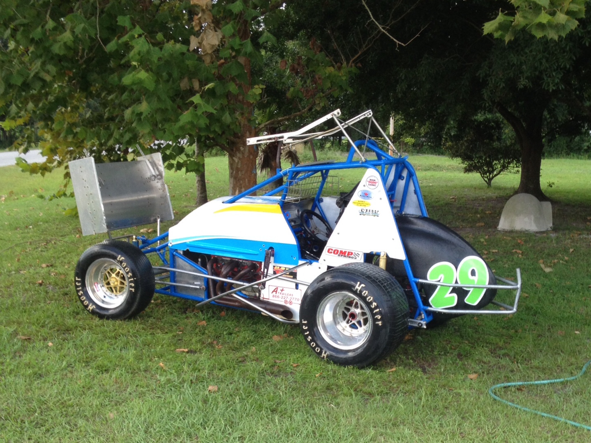

This is my "96" Maxim, I made a number of of performance upgrades but also a few safety ones also. I added the arm bars but also what I call my "cranium cradle" as i was concerned about belt stretch and body extension, these upgrades were done over a decade ago when sprint seats were not near as safe as the full containment seats of today. Also none of that helps in non wing racing. Not a great fan of thethering more parts to my car but could see room for stronger or better front mount to keep wing attached
Also I i am saddened at the loss of another open-wheel brother and send my prayers to the drivers family and friends.

Posted By: Sprintracer29 on September 21 2014 at 11:14:43 PM
As you probably know your top wing mount is no longer used.  They now use  internal runners.  The old style like yours is probably stronger but they do not use them any more for aero reasons.

Posted By: linbob on September 22 2014 at 02:31:45 AM
Actually the asphalt racers in the area use external runner wings for the added strength. No wing should be considered as a safety component, the fact that they help in a winged car crash is because they are there and that will not help in the 30-40% of classes without wings. Your first line of defense of safety is your chassis-roll cage and in no way should a driver depend on the "wing" to save their life. We all put ourselves at some risk every time we strap into a sprint car and the fact that this tradgedy happened in hot laps proves that. The average sprint chassis haven't changed much in 30 years but I have seen a frame made with a containment area that looks like it was taken from some of the tractor pull rigs but can't find a pic of it. Also If you look at the top of my cage you can see that hoop extends above the rail of main cage so that it would ride or skate along on that before contacting the main cage and reduces the size of opening in top to help in an "Opperman" type wreck.

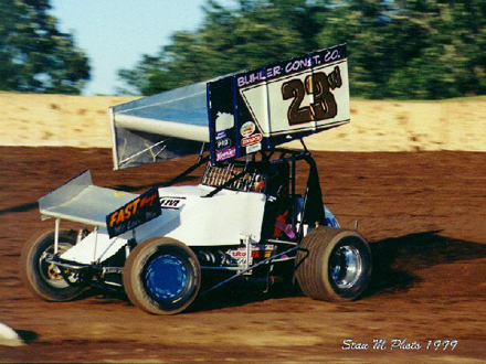

Posted By: kpwinters on September 22 2014 at 08:36:50 AM
Hey linbob how do you hold the wing on your sprint car??
Here's a shot of a Sprint Car with the wing securely fastened.  This one was taken back in 1999.  I believe this was up in Brainerd.  wink
Stan Meissner
kpwinters
September 22, 2014 at 11:51:11 AM
Joined: 02/11/2005
Posts: 64
Hi Stan!!  Have not seen you for awhile. Yes I just dont understand the tether talk every time something flys off one of these sprint cars!! If it was only that simple. I think I know that guy in the pic you got up there. Would love to hop back in one sometime. Might have to make that happen before the 23w retires. Would like to bang wheels with Scott a few times before we quit too.
